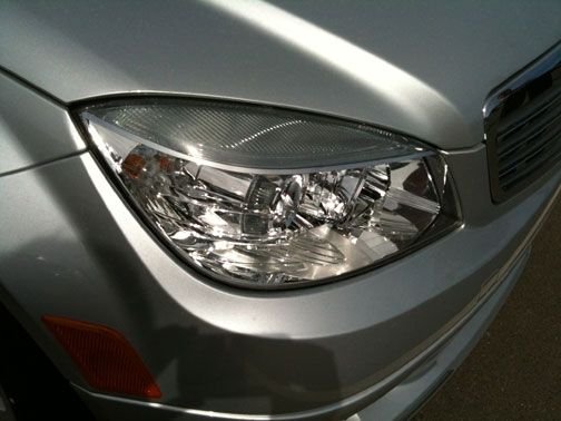

Figure 1. Before blacking-out headlights.

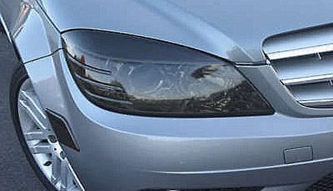

Figure 2. After headlights have been painted.

Figure 4. Tinted headlight lenses.
