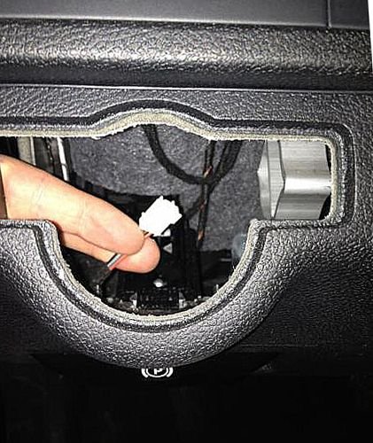

Step 2 – Remove the wiring harness
Reach with your hand behind the headlight switch underneath the plastic kick panel, and release the wiring harness. The harness is secured with plastic electrical harness clips. Unclasp and go.
Figure 3. Wiring harness clip.
